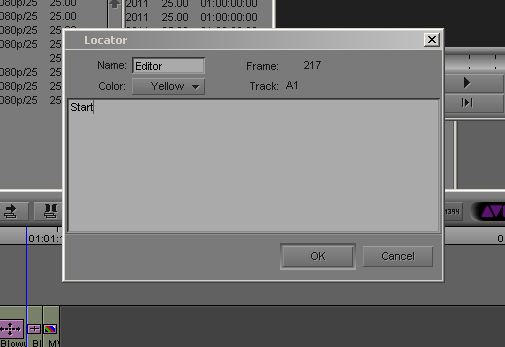

    Locators not to interrupt playing the timeline when adding them (no Popup-Window). This seems to be gone (or where is it hinding?)
    You need to set that option. Open the Locators Tool, and from the hamburger menu to the bottom left of that tool, select 'Disable popups when playing' (or always).
    exactly this is the dialog i am missing. look at the screenshot, there is no hamburger menu.Locator_without_Hamburger

    You need to go to the locators menu in the tools menu to find the hamburger to disable locator popup. One thing I wish was that there was a way to apply it to ALL new projects as a default.
    Yes!  there it is! Thank you! Its not gone. I've searched it under the Settings-Tab. Wouldn't be better to have all possible Settings of MC being represented somewhere in the Settings tab? Someone even never know of such a feature.
    Edit:  Strange, under Mac Version 5.0.3.5 i can see that "Locators" Button I was missing and what opens the "Locators Tool" with that Hamburger menu. But under Version 5.0.3 on my PC (see the Screenshot above and below) it is gone... thats why i got confused. anyway not big of a deal but irritating
