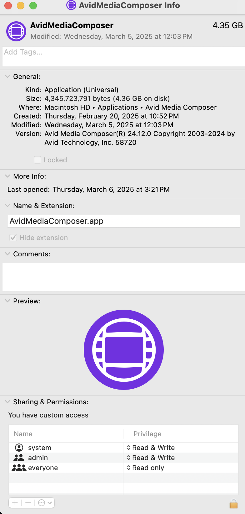

    Hi. Try right clicking on the mc app itself in application and go to get info. Is Open using Rosetta checked or unchecked? It should be checked for the imac 2020.
  • Thu, Mar 6 2025 6:15 PM In reply to
    Re: 24.12 Complete Failure
    Great thought... interestingly, the Rosetta option is not even there at all.
    2022 Mac Studio, M1 Ultra, 128 GB RAM, 20-Core CPU, 48-Core GPU, Avid DNxID, 32 TB SSD Thunderbolt 4 RAID Storage, Media Composer 2024.12, MAC OS 15.3... [view my complete system specs]
  • Thu, Mar 6 2025 6:26 PM In reply to
    In looking more closely at this I see that 24.10 is an Intel app. 24.12 is a Universal app.  Not sure Rosetta is needed for a Universal app.

    More importantly, Rosetta is not used on Intel-based systems like yours.  It is a translation layer that lets Intel binaries (like Media Composer 2024.10) be used on Apple Silicon hardware.

    To open Media Composer natively on Apple silicon:
    1. Open the Applications folder for Avid Media Composer.
    2. Double-click the AvidMediaComposer app to start Media Composer.
    Note: If you have previously opened the application using Rosetta emulation, you may need to uncheck the "Open using Rosetta" option as discussed in the next section.
    To open Media Composer using Rosetta emulation:
    2. Right-click on the AvidMediaComposer app and choose Get Info.
    3. Select the checkbox for "Open using Rosetta".
    4. Double-click the AvidMediaCompser app to start Media Composer.

  • Fri, Mar 7 2025 4:57 PM In reply to
    Hi Marianna!
    The use Rosetta checkbox is not there when I select Get Info unfortunately.
